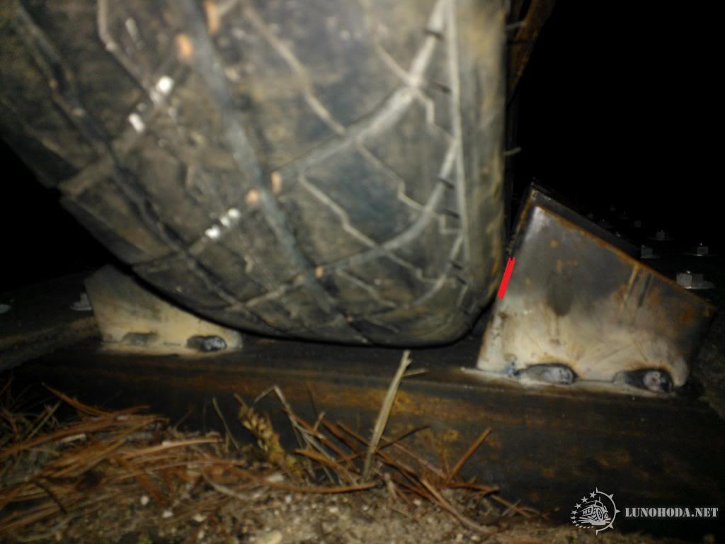

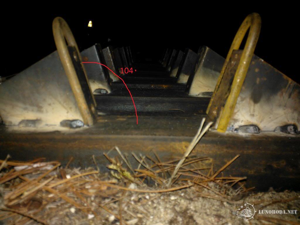

Hello everyone, please forgive my Russian as I am from United States and I am using a machine translator. I am building a caterpillar rover. My question is in regards to the truck fang contacting the sidewall of the tire. I am using tires that are called temporary use tires, they have 2 plies at the sidewall. Will the contact area picture cause an early rupture of the tire? Many thanks.
