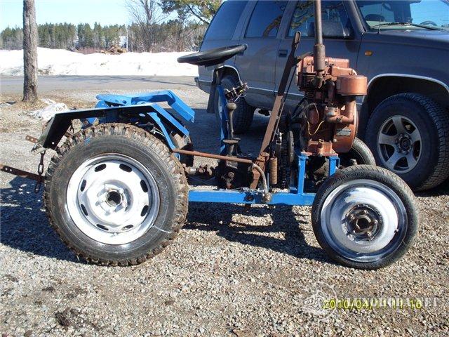

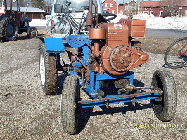

Hello my name is Jörgen and I live in sweden,
I have been inspired from your tractors, and I´m building my own,
I don´t understand russian at all. only english,
But I use google translator.. Heres som pics of my tractor:

Yes its for my garden, I plans to build a 6" deep furrow plow for it, a harrow a potatoe hiller/plow and a snowplow.. Yes i building it myself, there is still som to do, theres no brakes yet, but maybe tomorrow. I also looks for some other rear wheels. those are old rally ice tyres, so there is some spikes left.
Its mostly build out of scrap and salvage part from me and my friends,

Jörgen
It not a garden tractor. It is a small true tractor.

Вован Я писал(а):Use specific work or all standard?
As beside you with work manually?
Use for many purpose, both snowplowing and, Gardenwork, Im thinking of building a small dumptrailer for it too.
Yes, I will still do some manual work.

WadeRover писал(а):Hello Jörgen!
In Sweden, too popular large pneumatic wheels?
You have to do it yourself or have these wheels are for sale?
The front tyres are wheelbarrowstyle sparewheels from an old vw rabbit, and the rear wheels are old Rally, winter/ice tyres, with som spikes left. im planing to build some ironwheels for use if theres to muddy. I have a old horsedrawn sicklebar that I can collect the wheels from.

А задние колёса от чего? Вообще, расскажи подробней процесс создания. :)
Where are rear wheels from? So, please tell us about creation process of your tractor. :)
